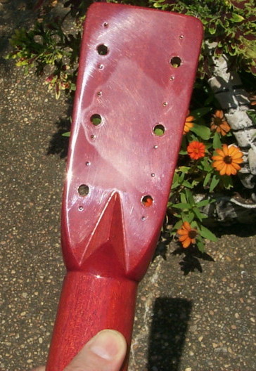

Enclosed is a photograph of what I assume are witness lines where I sanded through the topcoats(Stew-Mac waterbase lacquer) to the sealer coats.  If you agree this is the case, I am wondering what I should do to correct the situation.
1. Must I sand with 320 grit ( or would 1200-2000 grit be OK?) to get good adhesion in this area and then spray several ( how many would you suggest?) layers of waterbase topcoat?
2. Can I just spray the immediate area of the witness lines or do I have to spray the entire neck with the new topcoats?
3. Would it be possible to French Polish over the witness lines to correct?
Any thoughts/help would be appreciated.

PostPosted: Sun Jul 22, 2007 9:12 am
Bill, I spray Nitrocellulose lacquer. Each successive coat burns into the previous coats, so there are no witness lines unless you use coats of Epoxy fill, which you can sand through, causing a similar problem.
I really don't see a way to fix your problem without stripping or sanding back. Probably not what you wanted to hear.

Bill, I recently got what I thought were witness lines with USL, but I think it
has something to do with rubbing out the finish using water. If I use
abralon pads without water, I don't get the "lines." Yours looks quite a bit
different though, more like the layers didn't adhere and actually
separated in the middle??? Or maybe just real witness lines.
You might give dry sanding a shot though before sanding back and
spraying more. Abralon pads can be found at some auto paint stores. I
have been using 1000-4000 grits.

The most common cause of sand through, which is what you show in the picture,(not witness lines) is sanding with out a back-up pad and trying to sand too quick and aggressively. Remember we are trying to form a level surface without sand off any more film than required to achieve the level surface.
It really does not mater if the finish is waterborne, nitro, or whatever. You need to clean off often and check for sand through. Soon as you see a sand through start, STOP don't sand in that area any more. This should leave you with only a small opening in the film.1/4" diameter or less. Finish sanding everywhere you can with out going through. Clean up, then respray those areas that need touch up with 2-3 more coats. With USL you could allow a week before leveling those areas out and you should be good to go.
Remember to use a backing block and light touch and you will have a lot less of these.
PostPosted: Mon Jul 23, 2007 3:16 am
Be sure to clean up the sand through well. You do not want to leave any finish dust at all in the boundary of the sand through or anywhere else for that mater. Or you will end up with witness lines

Bill-did you clamp your headstock in a vise to rub out the rest of the neck?Looks like a clamp mark!
I've used Stew-macs H2O for years and have never had this problem!
How long did you wait before rub -out?
How many coats?
Yes you can respray JUST that area -make sure there is no polishing coumpound residue left!
Just ruff up the area with synthetic steel wool and re-spray!
Put on enough coats so you do NOT sand through again!

Yes, I think I caused the witness lines by overzealous sanding of the area as I was trying to remove a "V" created in the back of the headstock by earlier sanding ( while still in the white) of the triangular pyramid ( I'm sure there's a better word for this) just below it. I didn't notice the lines until I applied the finish. I will chalk this up to being a newbie and not paying enough attention to the smoothness of the wood in the white. Oh well, I think I've just learned another lesson that will be hard to forget. But it's all about the journey, right?

Yep, been there & done that.  "In the white" sanding quality is the first key to a great finish.
I've been getting myself in the habit of finish sanding (dry) all the
way down to 1000 grit Abralon (or higher with harder woods) so that I
can find all these kind of imperfections and fix them before the finish
goes on.  Then I will go back over with 320 grit or 400 grit
before applying the first sealing layers.
